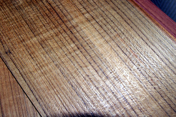

I bought 2 boards of this wood as African Teak. But, it defies most all of the characteristics of what I would expect from real teac. It's my understanding that most of the remaining teac logs are fairly small in size. These boards were 12' long, 10.5" wide and 2+" thick and perfectly quartered the entire width. This would indicate to me that it came from a fairly good size log. It's not heavy at all. It has been kiln dried and straight as an arrow. Resawing it was a breeze. It cut like butter. Sanding is very easy as well. I would put the working properties in a category similar to spruce. But, from my experience (which is little) and from what I've been told, teac is very hard and is supposed to dull tools very fast. I didn't find that to be the case with this wood. However, the one characteristic that does fit the bill is, it has a waxy feel to it. It also has a very unique and sweet smell with a very sharp tap tone. Regardless of what it is, I think it has great qualities for an instrument. So, it's kind of got me stumped. I tried to take a good close up photo of it so maybe someone could help me to clarify what it is if it's not African Teac. I've seen furniture and other things made from Asian Teac and this looks nothing like that. I know it's imported and not native to Brazil. So...anyone have any ideas ????

Well, this wood looks very nice. The real test, as you know, would be to build a guitar with this beautiful wood.

"Oldfieldia Africana, used in ship building." (you probably Googled the same thing as me.)
Evidently, a little known wood. If not for the waxy sheen, and the medullary rays, it looks like Zebrawood. Pretty stuff.

Jeff, that looks just like a piece of Zebrawood here at my shop. I would jump in and say that it definitely is, except that the "waxy feel" you describe gives pause.
So--not sure, but it really is pretty, and well quartered. That will make a stunning guitar!

Jeff, is it sitting on some purpleheart?

I'm with Steve, I would say it looks like Zebra Wood.
I have a very nice set Steve sent me but as he said it feels almost like maple to the touch, but not waxy.

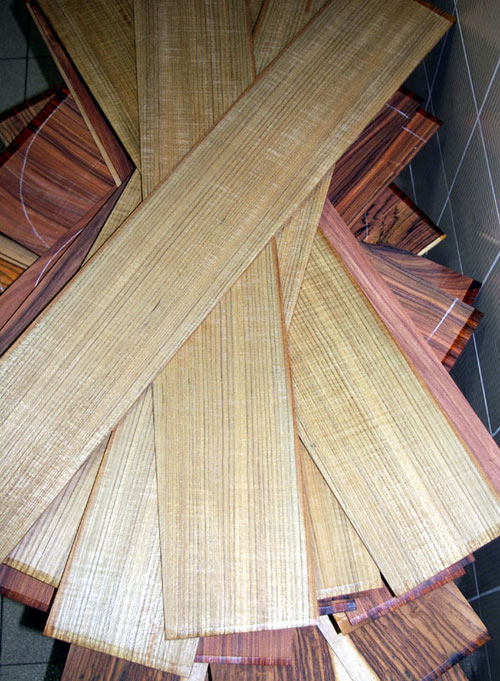

Dennis..I believe you're right. "Oldfieldia Africana" seems to fit the description except it's not as heavy a wood as they describe. These boards are fairly light in weight but, all the other properties seem to match. Due to the cost of this wood, I can't imagine using it in ship building. It would cost a fortune !! Anyway, thanks for the feedback. Ken...that's not purpleheart it's sitting on..it's Pau Ferro and BRW. I just cut a cubic meter of backs and sides and was waxing the ends. And had the Teac on top of the stack.

Ooooh, Jeff, you could sell this picture for wallpaper.
(Except that now we all have access to it!)
That's a tempting pile of goodies there.

looks like african sheuda (spelling) to me. I have a set of it and it looks
VERY similar. The Shueda I have works and feels like walnut to me.
PostPosted: Thu Nov 10, 2005 7:54 am
John I was going to say that too Shedua or Ovankol. I have sets that look very similar. Only problem is Shedua is not that expensive. So there's always one part of this puzzle missing. I once had some teak that looked similar and wasn't heavy either but it did feel waxy.

Teak's used in boatbuilding (decks and the like) and it really is quite pricey. So that's not something that's gonna stop most boatbuilders. As for Ovankol/Amazaque/Shedua, the test is simple: does it smell incredibly nasty, or not?Mattia Valente38666.7237152778

Mattia..this wood doesn't smell nasty at all. It's hard to describe but sort of a sweet odor. Not at all offensive but unique. It's a new one for me.

OK, not Shedua then. Because I've yet to meet someone who'd describe that smell as 'sweet' and 'not offensive'

It looks like Teak that has been plantation grown, most likely from Costa Rico or Mexico. Central American grown Teak is usually lighter in weight and density than Asian teak. Plantation grown teak oftens has much less oiliness.
Additionally one of the differences is that in a tree farm all of the trees are planted at a closer uniform distance to encourage faster growth yield so the growth rings are wider as opposed to forest grown teak which has tighter and less even rings.

Possibly Chlorophora excelsa, most commonly called Iroko, but also called
Nigerian or African teak. Waxy feel fits. It would have a yellow color when
freshly cut that quickly turns to light brown.

It doesn't look like the Iroko I've used, which was quite a bit less dramatic in terms of grain/background colour variation. Could be, though. Fairly waxy, dust is a pretty nasty irritant, yellowish when fresh, brown later, even browner after that.

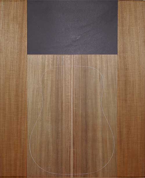

Howard..it does have a yellowish color when fresh cut and does, within a day or so, turn a light brown. And Luigi..it does look somewhat similar to your example but doesn't have as much color variance as your example and the grain is a little more defined in this wood. It could be that this is just quartered a little closer though. Mattia..when you sanded the Iroko...does the dust become airborn?? When this is sanded it doesn't make airborn dust. It tends to stick together and hasn't been an irritant at all. It's a real stumper for me. But, all the input is appreciated. I think I will call the supplier I bought it from tomorrow and ask where it was imported from. That might narrow it down somewhat. However, they were very sure of it being named African Teak. In portuguese "Teca". Here is a set I just finished sanding. You can see the difference in the color of the sides and back. The sides were sanded out a couple of days ago. The back was just sanded today.
Irregardless of what it is...it's has a great ring to it and all the right properties for building instruments.Brazilwood38669.7332523148

I've built some furniture out of Iroko, and just used it for a steel string neck. The planks I have are quite light, certainly no heavier than mahogany, and have a definite waxy feel. The stuff I have looks very similar to your picture, and the color change fits too.

I just looked up Iroko in Constantines wood identification book and it says "Iroko, originating on the west coast of Africa, is also known as African or Nigerian Teak..."

Thanks Paul..I'm feeling fairly certain that's what I have. Do you happen to know the scientific name ? I don't have the book you are referring to and it would be better to have the name it gives. It should be great for necks...the stuff I bought was very long pieces and straight as an arrow. That's one of the good properties of teak from what I've read. It doesn't warp Was the stock you bought very expensive ?? Just curious. Regards and thanks again for everyone's help.
